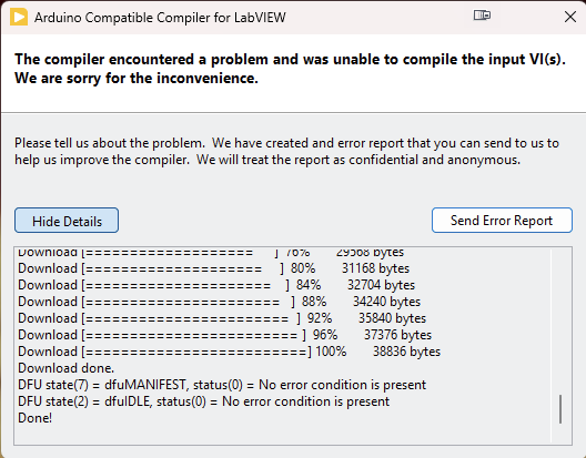

I did manage to get it working. I think there were some path issues from previous installations or something.
There seems to be a false positive error that occurs even though the process completes without a problem.
The standard Error dialog pops up with "The compiler encountered a problem..." even though there is no error condition present.
Complete Error Log Details:

Looks like that is because there are some "error" text instances in the Log details and the Compiler triggers off any error text in the output even though it is "No Error" in this case.  Prior boards only printed error text when there was an error.  You could try disabling verbose outputs with the "show verbose output" option in the IDE Preferences if they are currently enabled.
