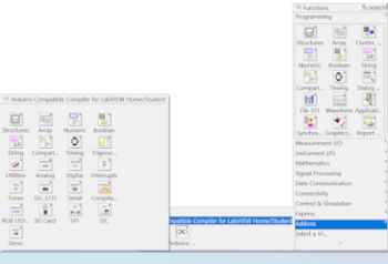

Hello,
I followed the installation instructions on https://www.geverywhere.com/et.....net-addon/ but the Ethernet folder didn´t show up in LabVIEW. Picture below. Sorry for the low quality image, I was getting a message that file was to large, even been around 70 kb.
How should I proceed to have the Ethernet tab/folder into LabVIEW?
Thanks.
Ethernet.pngImage Enlarger
June 15, 2022
7:19 pm
dan07
Forum Posts: 5
September 20, 2015
I realized how to do that.
I followed https://forums.ni.com/t5/Devel.....-p/3520557
Thanks anyway.
