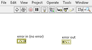

Since there is no input / output,  I create from the template lvlib a Shutdown library that looks like this:
shutdownLib.PNGImage Enlarger
with Shutdown_Idle only containing Error in and Out clusters since the shutdown is just a call onto the sleep.h API.

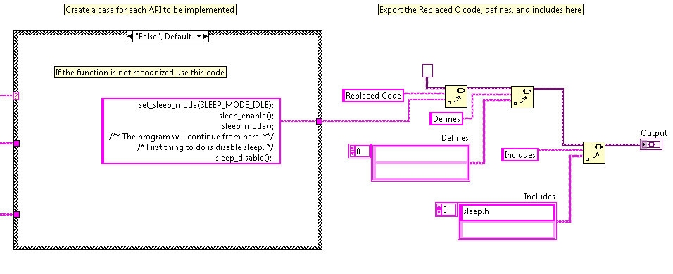

The translator.vi, since not using any I/O,  I suppose can be reduced to this:
translator.PNGImage Enlarger
When creating a basic test.vi and looking into the code generated, it shows the following, which I assumed indicated the translator was ok:
#include "LVArray.h"
#include "A4Lhelper.h"
#include sleep.h
void setup()
    set_sleep_mode(SLEEP_MODE_IDLE);
      sleep_enable();
      sleep_mode();
      /** The program will continue from here. **/
      /* First thing to do is disable sleep. */
      sleep_disable();
void loop()
Also, the sleep.h file was placed into the [libraries] folder like the the template shows. It was copied from the arduino install folder.

...Oops...
#include sleep.h
should have been
#include "sleep.h"
September 9, 2016
9:20 pm
LDBM
Forum Posts: 11
August 8, 2016
Better yet:
#include <avr/sleep.h>
