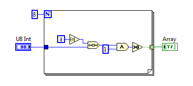

Since it seems that the native LV function "Number to Boolean Array.vi" is not supported in ACC4LV, I created one to convert U8 integer. I use this function to control Digital Port Output.
Let me know if there is a better way.

We will consider adding the Number to Boolean Array primitive in a future release, but, as you found it is simple enough to make a subVI for it.  Here is a slightly simpler, and possibly more efficient approach using boolean logic but what you have should work fine.
Byte-to-Array.pngImage Enlarger
