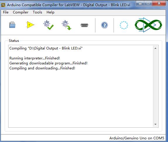

i use the example vi blink
nothing happen

You need to enter more information about your configuration (version of Arduino IDE, LV, OS, etc). Have you searched the forum for a similar issue?

Please look at the FAQs, specifically this one:
https://www.geverywhere.com/for.....load-code/

problem solved!
previous ide ARDUINO ARDUINO 1.6.12
try 1.6.11, problem solved
thank you!!!!
