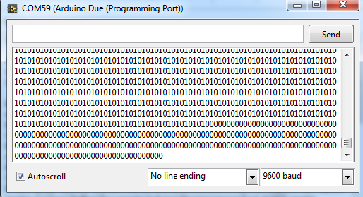

Everything looks fine to me.  I tried your code on an Arduino Due (very similar pinouts to the Mega) and both inputs worked as expected with the exact same code.  You might want to slow down the loop rate and identify which pin is which on your serial output.  But here is what I got.  Had one pin tied to ground then connected the other to ground (all 0s as expected).  I would double check your wiring.
Digital-Test.pngImage Enlarger
