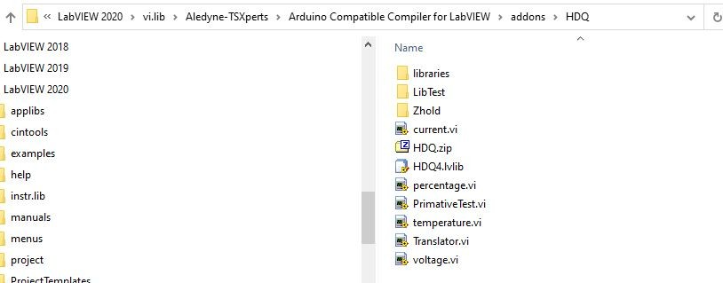

Steffan - The files above are located in the locations shown in the image attached. Since the translator and primitives worked perfectly on a prior computer, I believe the error must be in the code locations or something similar. The Arduino libraries have been tested in Arduino code on the IDE and they work in native Arduino code. It seems ACCL is not recognizing the LV code. Just my  observations...FileLoc.JPGImage Enlarger

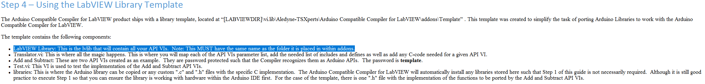

I think I see your issue.  Your .lvlib is called HDQ4.lvlib.  It should be HDQ.lvlib.  This is described in the user manual (see attached).AddOns.pngImage Enlarger
