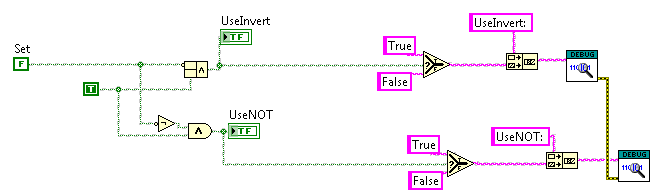

Hi,
I ran into some problems with the  LV Compound Arithmetic primitive.  The "Invert" setting on one of the logic AND input does not seem to work. I attached a test VI to deploy on an Arduino target.
- LV 2015
- Arduino compiler : 1.0.0.21

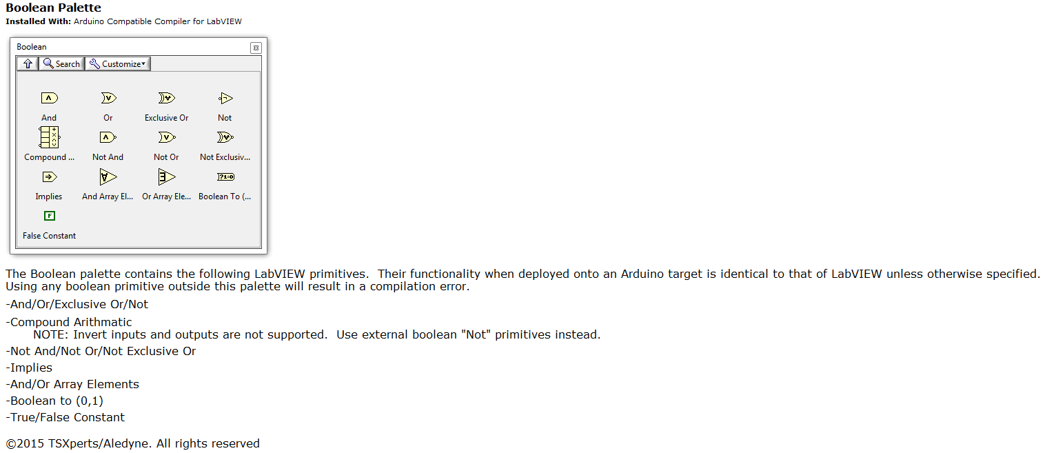

As stated on the Product User Manual, inverted inputs/outputs are not supported for the compound arithmetic primitive. Do a quick search for that term on the user manual and it will point you to the section of the manual I am referring to.
September 13, 2016
6:23 pm
Please read the help manual.  Inverting inputs/outputs on this function are not supported.
