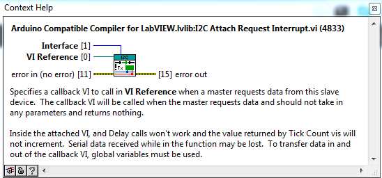

In working toward the Master/Slave loop-back code, I’m getting an compile error from slave code (attached) to service a simple request for a fixed message (code attached). What am I missing here?

I didn't look at your code (I dont have LV2015 setup yet on a VM), but from the error Im guessing you have an input (control) wired to the connector pane of the Callback where it shouldn't.  Take a look at the context help.  It says the callback VI should not take in any parameters (unlike Attach Receive Interrupt).  This is in line with the Arduino function call here.

I followed the context help for the I2C Attach Request Interrupt VI: nothing attached to the connector pane (no controls or indicators in the callback code to attach).
The code was saved for 2014; reattaching those 2014 versions just in case.

I looked into this one and it appears there is an issue in how the Attach Request Interrupt is interpreted.  I created Issue #126 for this.  It may be a few weeks before another release.  There may be a workaround through the use of a user library in the meantime to implement the callback handling properly.  If I have some time in the next few days I will see if I can try it out and can send it to you if it works.
