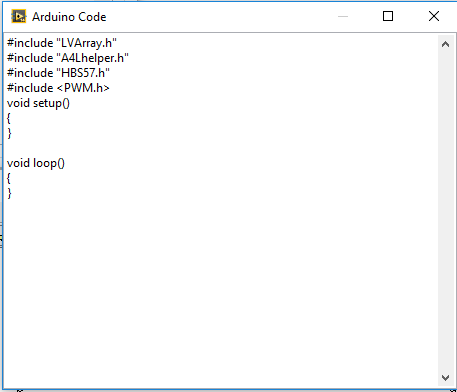

I am using porting api function on toolkit but face strange situation.
1. not inculdes "HBS7.h", <PWM.h>  but showing in arduino code
#include "LVArray.h"
#include "A4Lhelper.h"
#include "HBS57.h"
#include <PWM.h>
void setup()
void loop()

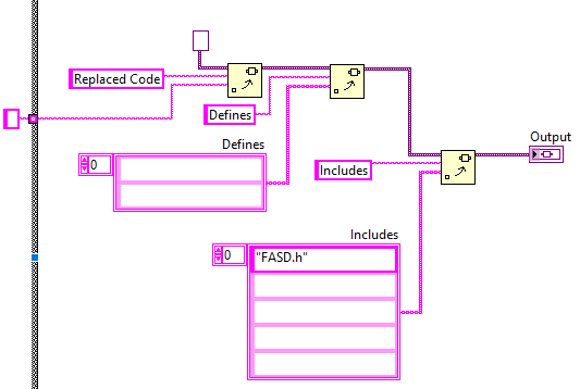

actually, i need "FASD.h", highlight area is my last porting api includes files.

The first thing that comes to mind is to make sure you are editing the correct "Translator.vi", which should be along with your VIs and in the same LabVIEW library. Because each library has its own "Translator.vi" and it is likely that you copied it from another library, it is very easy to edit the wrong one. Check the path of your "Translator.vi" by selecting "VI Properties".
