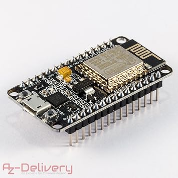

I use now NodeMCU LUA Amica V2= ESP8266 modul for Arduino

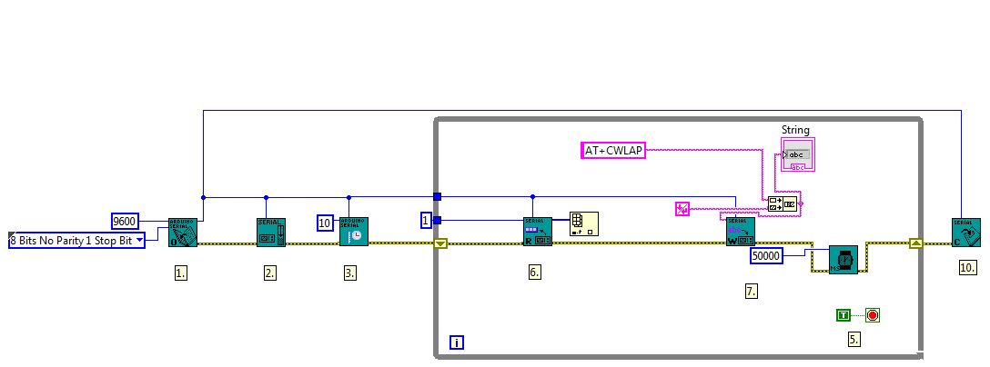

I want to sent from Arduino via Serial connections some strings like this:123456-1.JPGImage EnlargerUnbenannt3-1.JPGImage Enlarger
I can read it in Arduino Software--> Serial Terminal the same string what i wrote in Labview, but i can wait how long i want its doesnt come connected or OK... When i write it in Sketch the same string there are no problems. The same string... I have this option in your software for what? Can you tell me please?

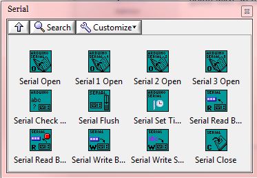

This question has nothing to do with your original question about the PWS API. I didn't understand what you are asking now. The serial VIs in the Arduino compiler are use to read/write data to the Arduino serial port. The compiler also ships with an example showing how to use the serial API set.

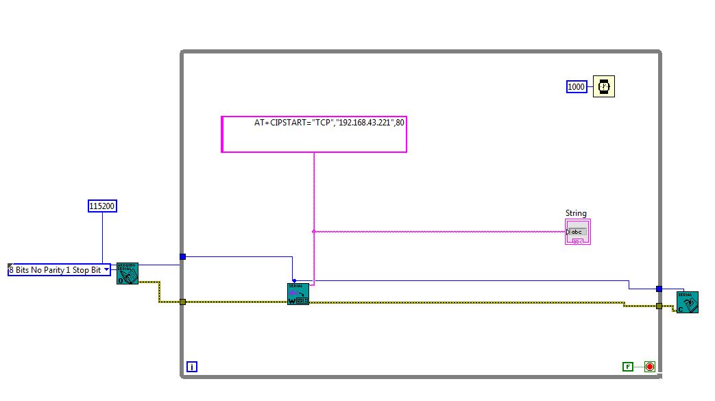

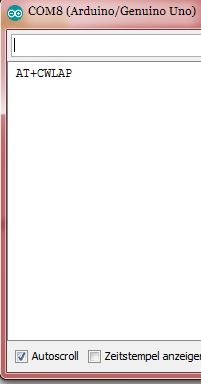

Sory It was my mistake. I used now your example Via, sure its work i have seriall connection with my PC, but i cant send any commands to my esp8266 its not your PWS its a normally modul for arduino i can send commands and connected with for example server when i send it via Labview= now1.JPGImage Enlarger
When i program the same string in Sketch it works.
now2.JPGImage Enlarger
