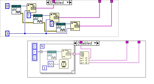

 I attach the snap screen of my code that read AI data from pin 0 to pin2.
Seqnece code can return correct data, but be replaced with for loop just return zero value.
Can anyone help me to clarity this question?

Something seems to be going on with this auto-indexed tunnel for Strings.  We need to look into this.  For now can you move your Number to Decimal String conversion outside the for loop?  It will handle a numeric array input outside the loop and the auto-indexing should work for numeric datatypes.

FYI, we have confirmed this is an issue and have created Case 125 for this one.  It only applies to auto-indexed String output tunnels so the workaround mentioned above should work for you.  We will hopefully get this rolled into the next release, which will be available very soon.  Thank you for bringing this to our attention.

FYI, version 1.0.0.19 has been released which resolves this issue and should be available for download on the LabVIEW Tools Network and VI Package Manager in the next few days.  See here for complete release notes.
