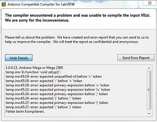

March 19, 2015
screenshot.JPGImage Enlarger
Hello, the compiler doesn't accept the wired "N"-connector of the for-loop. Strange error message
May 19, 2015
2:31 pm
It should accept the N-connector but the compile error is probably due to another reason.  Can you please send the error report within the compiler when prompted or post your VI here and indicate what version of the Compiler you are using?

March 19, 2015
Steffan said
here are the screenshots of the error message and the VI. I use the 1.6.1-compiler

May 19, 2015
3:52 pm
John
Forum Posts: 18
March 19, 2015
@ viwoi,
Tested your vi,
When you connect the output of the "serial length" to an indicator and connect a local variable of this indicator to the "N-connector" the vi will compile without failures.
Perhaps this info will help Steffan.
May 19, 2015
4:29 pm
viwoi
Forum Posts: 16
March 19, 2015
John said
@ viwoi,
Tested your vi,
thanx John, currently I am using the auto-indexing function of for loops. In case of strings I convert them to a byte-array first. Then pass it to the for loop. Not fine, but works.
I also noticed, that the error-wire should not be connected to a "?"-connector of the case-structure. It provides also some "strange" errors.
May 19, 2015
5:08 pm
We are analyzing your VI, thanks for posting it.  As John noted, you can use that as a workaround.  Thanks John for posting it.
I have created Case 90 for this issue and hopefully it will be fixed in the next release.
Also, yes, you cannot wire error wires to case selectors.  Please refer to the "Important Considerations" section of the user manual for more details.  Error clusters are used for flow control only and not intended for functional use.
May 19, 2015
10:15 pm
@ viwoi and John;
Guys;
Thanks for reporting/helping with this. Just chased down the issue and it has been addressed. The fix will be rolled into the next release of the compiler.
