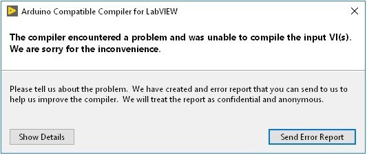

error-message1-1.jpgImage Enlargererror-message2.jpgImage Enlarger
Error mesage is attached.

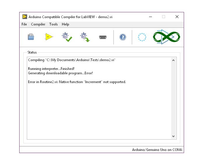

I continue to learn examples and found that simple VI's with Structures only without any mathematic and hardware functions produce error during Compiler>Verify but display Compiler>Arduino Code complete this function and display Arduino Code window.
In case I add Increment by 1 function (takken from Arduino conmpatible functions) at VI following error appearsIncrement-error-1.jpgImage Enlarger
December 15, 2019
11:21 pm
The Arduino Code option is only for developing custom libraries.  Refer to the help manual section Porting an Arduino Library to LabVIEW Step 5.  For your first error when using Verify or Compile and Download, please "Show Details" and post the details for the error message.

I followed your explanation at Error Compiling Examples post and replaced to Arduino v1.6.6 and it solved problem.
